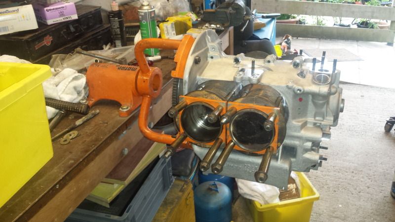

Postby caveman » Thu Nov 12, 2015 7:16 pm
so I have spent some time on it again, I managed to get the small block built up with all the bearings coated in assembly lube torqued the case nuts and the studs inserted with Loctite to help prevent leaks,Image
i the came up against what i shall call "my luck" i bought a set of pushrods tube from a supplier ( I'm not too sure who) and didn't check them and when i came to use them i have a magpie in the nest lol - ade has a set he will give me that have been painted black to aid heat transfer . hey ho lol next time its longblock time Image

Postby caveman » Sun Mar 06, 2016 9:29 pm
so I have done some more work on the engine , I have added the barrels and pistons and added the cylinder heads that we previously measured at 49cc we have also worked out the compression ratio to be correct with the shims we fitted ( I forget the sizes but I am sure it was all good at the time lol)
I also fitted the sump plate with new strainer and gaskets etc
I will change the end float soon as I don't fancy a seizure
