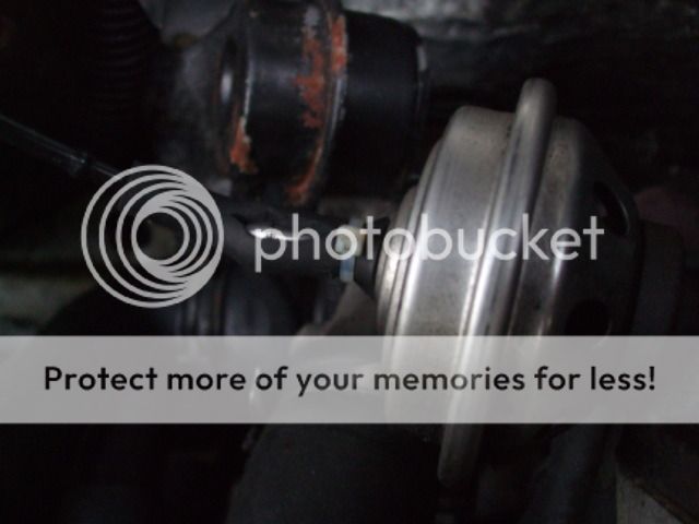

Evening people.
Any idea where I get a bit of this, local if poss?
Thanking you kindly in advance.

same as the injector return pipe
Just a couple of quid for a length
Will probably be giving you poor braking I guess feeling like nothing happening.
Don't bother, remove it and any similar line that goes to the pump or wastegate actuator. Then blank it off down at the vac pump/servo connection.
Then remove the EGR and blank that as well.

Postby hotdoggermark » Sun Nov 24, 2013 5:25 pm
Well, the new pipes on now.
Reg, as you might have guessed I know f**K all about engines but what are the benefits of doing what you suggested mate?

Postby regcheeseman » Mon Dec 23, 2013 11:32 pm
It's the EGR actuator, best removed altogether. Fills the inlet manifold with carbon build up.
Probably teamed up with a NOX reduction device on the front of the pump, this reduces advance at high revs, killing power.
